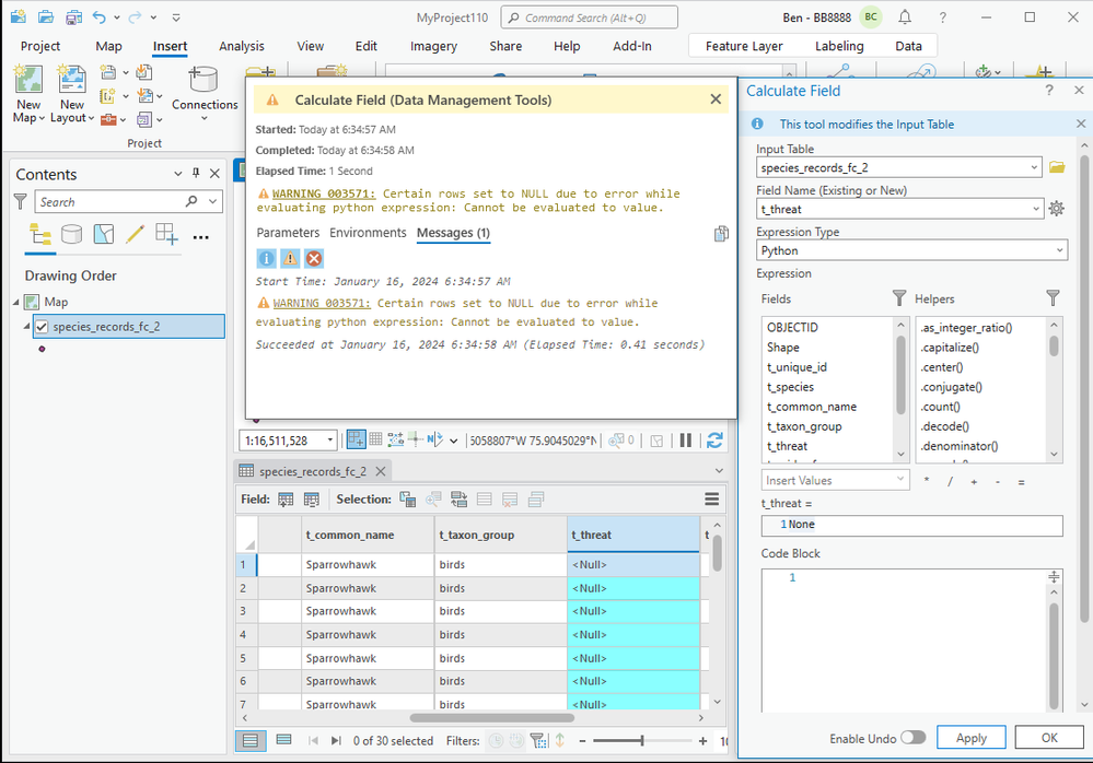

In a point feature class, I want to set a text field to null. So I use the Field Calculator tool to set the field to None (Python).
The field calculation works as expected. But I get a strange warning:
WARNING 003571: Certain rows set to NULL due to error while evaluating python expression: Cannot be evaluated to value.
Esri says it's working as designed.
Esri Case 03528633 - Field calculation to set values to null/None: WARNING 003571 doesn't make sense
Calculating "None" Using Field Calculator Yields "WARNING 003571"
But that warning causes confusion for users.

MErikReedAugusta
I get such a kick out of this warning message every time it comes up.
Task failed... successfully?
I actually looked into this a while ago and found a message from someone I think at ESRI indicating that this was as-designed.  It's a weird way to do it from a user-perspective, but there's at least some sense from a back-end perspective.
Bypassing this error for intentional NULLs would mean another check that the system has to do before displaying this error.  It's weird, but it's technically more efficient, in theory.

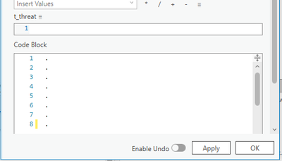

Unrelated to the topic at hand: I see line numbers in your code block!  At last!  Is this something that was recently added, or is this a setting I just haven't found, yet?  I've long wondered why none of the built-in code block windows show line numbers.

@MErikReedAugusta
About the line numbers in code blocks: Nice, I hadn't noticed. I don't know when that functionality was added to Pro. I didn't enable a setting or anything like that.

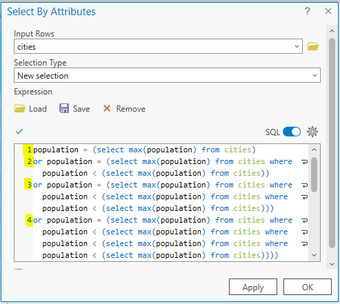

Bud
by
@MErikReedAugusta
It looks like the row numbers handle word wrapping appropriately, too, which is good.
Source: What tool can select the records with the highest values in a particular field?
