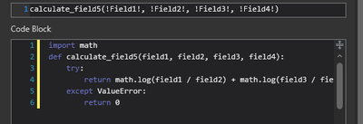

Hello @BeckHag
You can accomplish your goal using the code block:
import math
def calculate_field5(field1, field2, field3, field4):
    try:
        return math.log(field1 / field2) + math.log(field3 / field4)
    except ValueError:
        return 0
