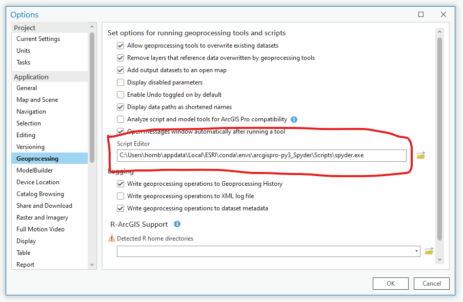

But the upgrade lost its link to the default script editor, so I reset that under the GeoProcessing Options as shown below:

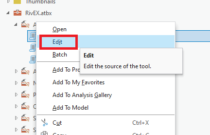

But when I right click and choose edit on my toolbox that I am developing python scripts in it opens the script up in the Windows notepad and not spyder.
It seems to unpack the tool script into a temporary folder location, for example C:\Users\hornb\AppData\Local\Temp\ArcGISProTemp14556
I'm desperate for advice as I am unable to develop my code, I need to open it in spyder, not windows notepad!
