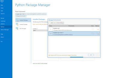

FraserM_0-1652635548324.pngLong story short: when I click the clone default arcgis pro python environment, it clones. And then when I click the dot next to the cloned environment to select it, then press ok, I get stuck with the loading bar (as per the attached image) for ages (30 mins + ) with no sign of the new environment being activated. If I restart Arc the cloned environment has not been activated. Am I doing something wrong, or is this just a bug? I've restarted my PC and the issue persists.

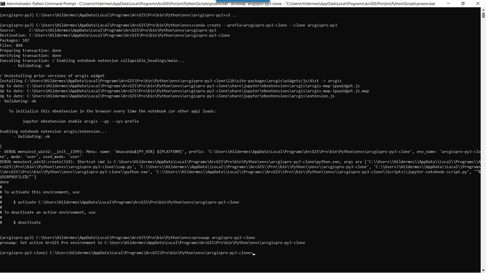

If I were you I would clone it mannualy.
  1. windows + x
  2. search "python command prompt"
You should see somethin like this:
You are now at yours active conda env
cd pathWhereYouWantYourEnv
conda create --prefix=arcgispro-py3-clone --clone arcgispro-py3
proswap arcgispro-py3-clone
The img bellow shows the steps:
And that it, have fun coding.

cool taht workerd, thank you

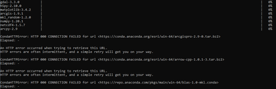

Thanks for the solution. I am using the conda command as you descibe, but I get the error "HTTP 000 CONNECTION FAILED for url ..."? Downloading the packges in the internet browser works.
It didn't help to set ssl_verify to false
conda config --set ssl_verify false
"k" parameter also didn't work (runs the command in the insecure ssl mode)
conda create --prefix=arcgispro-py3-clone -k --clone arcgispro-py3
Any ideas are highly appreciated.
Hildermes
Hello, @Chess .
If I'm not wrong, that 0% it is a indicator that your system is blocking your python to do internet connection (firewall or antivirus might be the culprint).
If you are in a corporate worskpace you might have at least 3 options:
- Ask the IT team to check the firewall;
- Ask the IT team if you can use a router wifi ( It could be your phone or they might have one, without the firewall rules).
- Do offline clone;
If you are at home just change your firewall rules, or check your antivirus rules.
