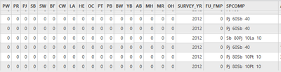

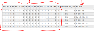

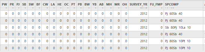

Good day all,

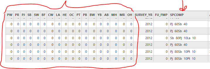

I have a layer with the following fields in the attribute table:
I am trying to populate the species fields (PW, PR, PJ, SB, etc.) with the information found in the "SPCOMP" field.
All of the values that are in the “SPCOMP” field should be put into related individual species fields, and leave the rest of species fields to 0. For example, if the “SPCOMP” = “Pj 60Pt 30Bw 10”, that means that Pj=60, Pt=30, Bw=10. Then 60 should go under “PJ”, 30 goes under “PT”, and 10 goes under “BW”.
I've tried various different things through the "Calculate field" tool but have been unsuccessful.
I am thinking something like:
For field PW: if SPCOMP includes the text "Pw" return following number - omit the rest of the string, else return 0.
Obviously this is not in proper Python code, and would have to be repeated for every field.
If anyone has a solution, or Python code example to accomplish this, I would be so grateful.
Thank you

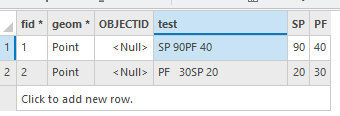

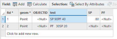

Sorry about that. The basis of the code was correct, but I forgot how to work with regex a bit (I only recently began to understand how it works) and had to change things around. (Also this code assumes that your species fields are integers. If they're not, you might have to play around and convert to text or something. Similarly, it assumes that each species field matches the value in SPCOMP exactly.)
My fields are a bit different (so I used fid and test instead of OBJECTID and SPCOMP), but below is the before and after. I made sure to test with any number of spaces.
One final thing: If you run an update cursor with the attribute table open, you have to refresh the table to see the changes. Also, this was written for a file gdb. If you're using an enterprise gdb, it gets a little bit more complicated.

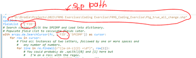

Hi Alfred,
I confirmed that my SPCOMP field is in fact text format.
Made the following changes to the code provided:
I changed OBJECTID to FID since I did not have an OBJECTID field:
Here is the error I am receiving:
Line 10 being:
 for line in re.findall(r"([a-zA-z]{2} +\d*)", row[1]):
Again your help is invaluable.
