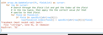

I amended your code and have been able to run through most of it - currently getting an error right at the end (line 41, 42):
I tried replacing "str" with the field name, 'Pw' for example or 'SPCOMP' but yielded no better results.

So, a key error is when you go to look something up in a dictionary and it doesn't exist. So it's looking for the value of 52 and not finding it and freaking out.
A way to get around this normally is to use dictionary.get(), in which you tell it what key to look for and what to return if you don't find it. (I don't use this in general because I find it confusing lol).
In this case, however, I'm not really sure what happened here. The str() is important because bad things happen if you use a true number (e.g. an integer) as a dictionary key, so I convert to string to get around that. But your value should be in there so ???
I'd give @JoshuaBixby's solution a shot. It's a lot more straightforward than mine.

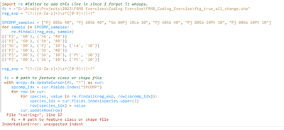

Hello Joshua,
This is great, thank you for doing the work and getting this written up for me.
I have been able to run the first part independently - however I am running into an issue with the second half.
Here is a screen shot - along with the error message I am receiving:
Note that I modified the beginning of the code to add: import re #Edited to add this line in since I forgot it whoops.
fc = r"D:\Brodie\Projects\2023\FRMG Exercises\Coding Exercise\FRMG_Coding_Exercise\ftg_true_all_change.shp"
reg_exp = "(?:([A-Za-z]+)\s*([0-9]+))+?"
Thanks again, I really appreciate your help with this (I am a floundering newbie with python).

Take that offending line out entirely.
In addition to the indent error, that line is redefining the fc variable to be ???? because you haven't put a value there, just a comment telling you to put a value there. (Edit: this will throw an end of line error, since it's expecting a value for fc. It just hit the indent error first.) You already defined the fc variable at the top, so you don't need it here. (Probably the same for the second instance of the regular expression)
Python relies on indentation to figure out how each line relates to each other, lines belonging to a loop are indented further than the loop open itself.
e.g.
for i in [1,2,3]:
    #Do something
    # Do something else
In this case, the offending line has one space at the beginning, throwing it out of line with everything else.
Also, so does the following line (with arcpy.da.UpdateCursor...)
Generally, 4 spaces (Or a tab, pick one or the other but not both) is recommended per indent level, but I think technically as long as they're consistent within whatever loop they belong to, you're fine. Four spaces is better for readability, though.
BrodieChisholm
HALLELUJAH!
It's working, you are all the greatest, I am so appreciative of all of your help.
It takes a community as they say.
