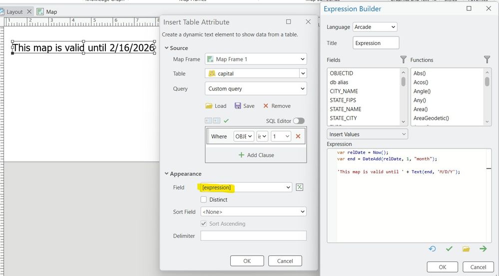

I can add the current date / time to a page layout using dynamic text, but is it also possible to add an interval to it?
Example: I want to add the text: This map is valid until [today + 3 months]
I am using ArcGIS Pro 3.5

Hi @BerendVeldkamp
One way you can do this is by setting up a Dynamic Text Value element with an expression.  This is outlined in the post - https://community.esri.com/t5/arcgis-pro-questions/dynamic-text-today-s-date-number-of-days/m-p/1052...
For example, using any layer (feature class or table) in the map I added the following expression:
var relDate = Now();
var end = DateAdd(relDate, 1, "month");
'This map is valid until ' + Text(end, 'M/D/Y');CurrentDatePlus1Month.jpg

BerendVeldkamp
Thanks, I didn't know dynamic attributes were a thing, but there you go.
One detail: It's important to check the Distinct box, or the text will be repeated for every record in the table.
