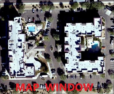

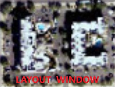

pkorst_coa
Experiencing the same issue.  Orthophotography is acceptably clear in the map window but becomes unacceptably blurred in the layout window and when sharing\printing from layout.
