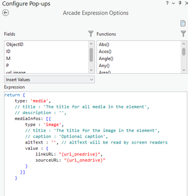

let's say I have an attribute field with all URLs  url_onedrive = https://sharepoint.com/test.png

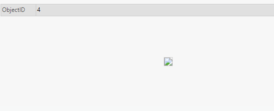

when I set in my pop-up as an Arcade expression:
The pop-up doesn't show the image:
What I'm missing here?
