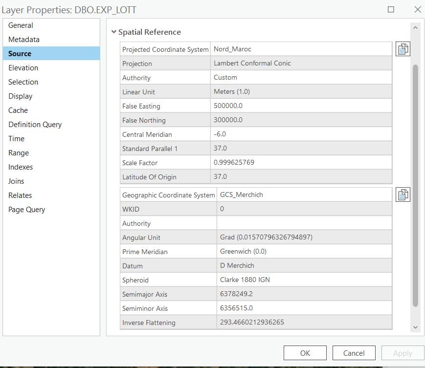

This is how the coordinate system is defined in arcGIS Pro 3.2 :

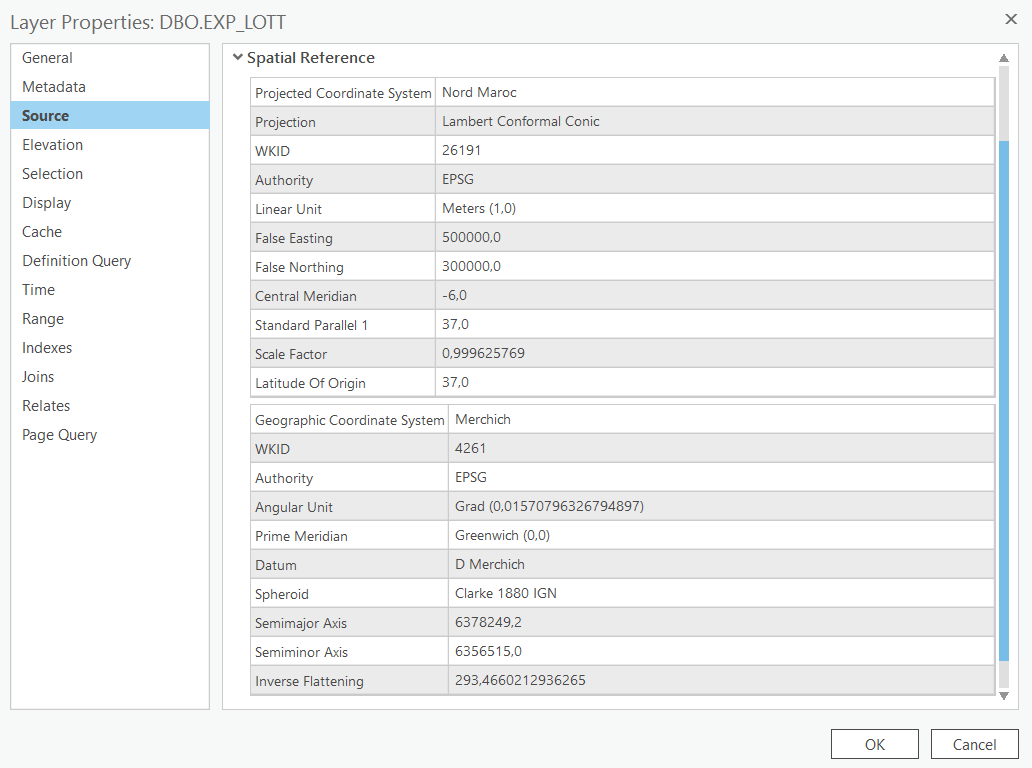

and this is the same layer coordinate system in arcGIS Pro 2.8 :
