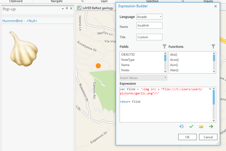

It might be a /
I put the following in an Arcade Expression and it worked.  Pro 2.3.2
Mark

There is another thing involved...  when you click on a 'File" link on windows the application associated with that file type will open.  For example when I link to a PNG file, clicking the link in the Popup window opens Snagit which is the program I have associated with a .PNG file.
It did set an attribute as you described, with the extra /  and it is working for me.
Mark

MarkBockenhauer
That kind of thing happens all the time... for my part I have always seen file: with the three slashes.. so I made an example showing it, and didn't really study your URL any further...   Working now though, so Good Stuff!
