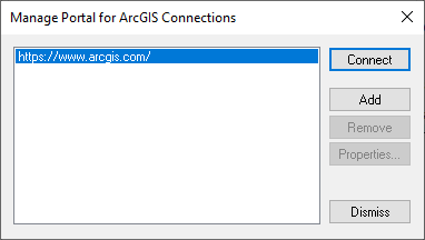

Hi, if I'm following correctly, you should be able to point your existing ArcMap install to the AGOL credentials for Org B.
First (with ArcMap closed), open ArcGIS Administrator. click Advanced. Click Manage Portal Connections. If necessary, add a portal connection to https://www.arcgis.com. Click Connect. Like this:
Next, start ArcMap. Click the File menu and click Sign In. Enter your Org B credentials in the sign-in window. At the bottom, check the Sign me in automatically box so you only have to do this once.
I think that should work.

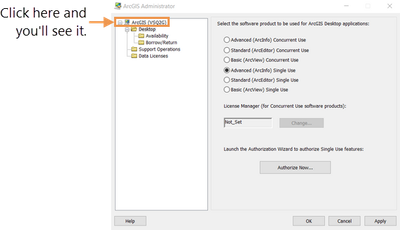

TimOrmsby
Hi, sorry, I missed an important point. You need to click on the top level node, the one with your user name. (In your image, you're one level down at the Desktop folder.)
It will look like this:

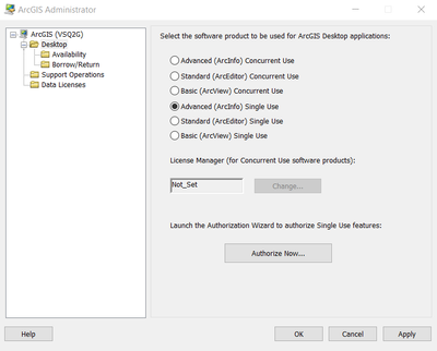

Cheers Tim.  I don't see an "Advanced" option per se. If I click on "Advanced (ArcInfo) Concurrent Use, and try to enter the esril url, I'm told it's an invalid hostname.
Here's what I see (present settings with single use lic.):
Perhaps I have a different version of ArcGIS Administrator as I can't seem to find how to get to portal connections?
Cheers
TimOrmsby
riogeo
by
Feeling a bit sheepish missing that one. Thanks for the help.  Sign-in worked good.  I'm up and running. Cheers!
