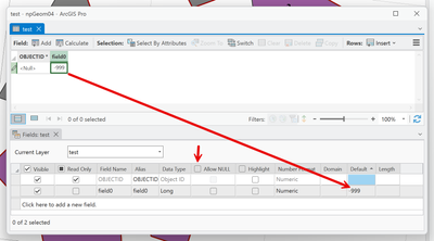

Have you tried to deselect that property for a field?
I was under the impression that it only works for an empty table
