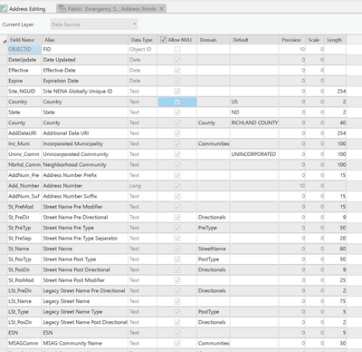

I am trying to customize my database to include better quality control.  There are some fields that I never want null.  So, I go to "field design" and attempt to unselect the "Allow NULL"  option in the fields I would like to never have blank, but they are all "grayed out" and I cannot change them.  See the screen shot below:
Any ideas how I can fix this issue?

Is your database a file geodatabase by chance?  My guess is this is not availabe in the file geodatabase format.  If you are using a RDBMS such as SQL Server, you can use SQL Server Management Studio to set a "not null constraint" on an attribute field.
In SQL, it would be:
alter table <owner>.<feature class>
alter column <column name> int not null
Hope this helps!

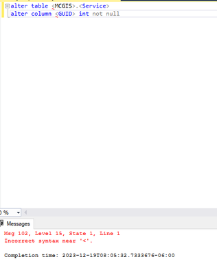

I am trying to complete this for a table (in a SDE). Can you tell me what is wrong?
Robert_LeClair
Esri Esteemed Contributor
Yes, remove the < and > - these are not needed rather just to indicate it's an owner name and table.  Based upon your text it would be:
alter table mcgis.service
alter column guid int not null
Let me know if this works for you or not.  Thx!

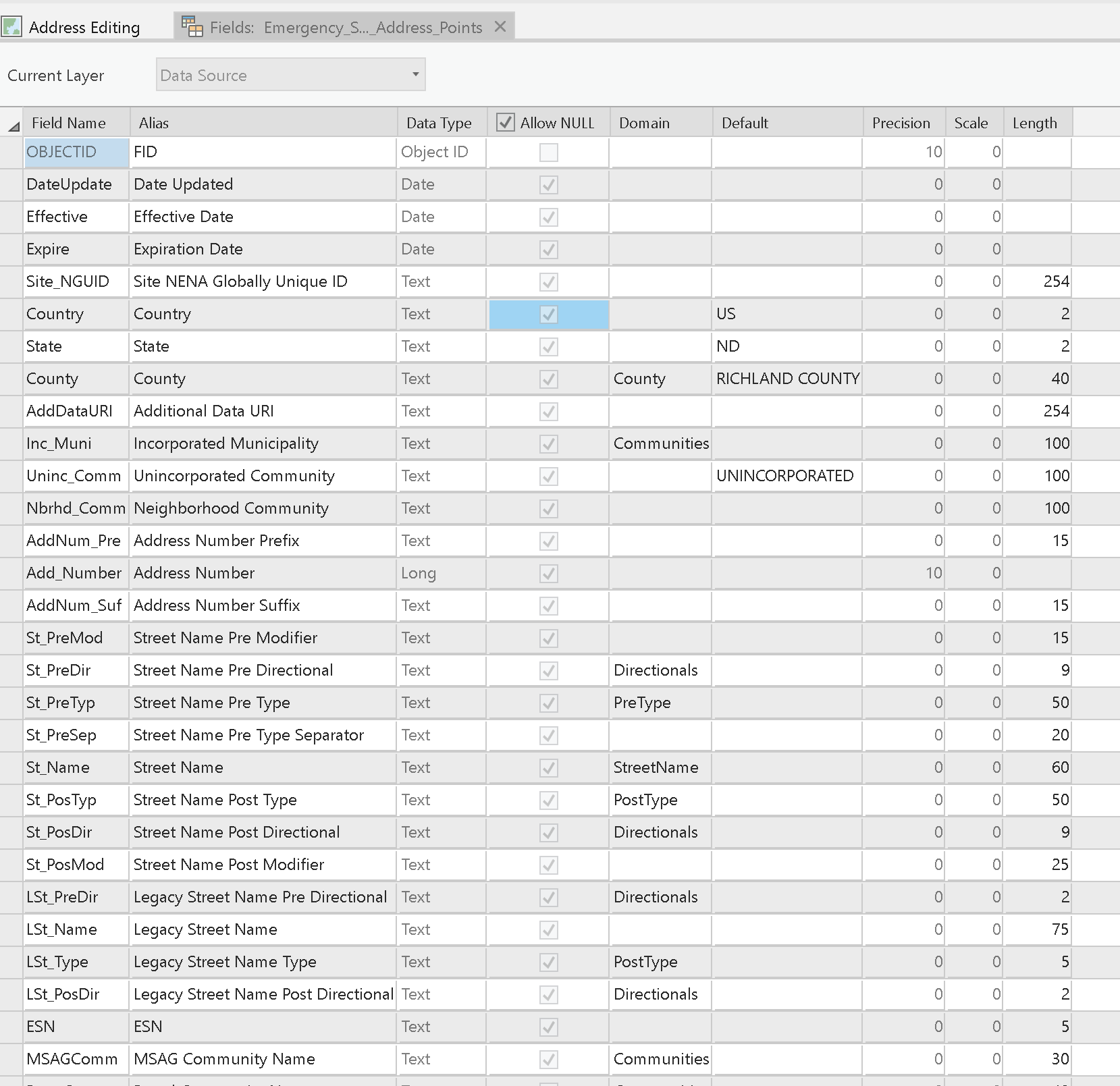

KeithAddison1
I'm running into this creating a new field, it won't let me make it nullable, box is greyed out, layer is a shapefile.

@KeithAddison1 - shapefiles have limited NULL support.  Date fields support NULLs but are stored as a zero but display as a NULL.  With text and numerical values, true NULLs are not supported.  You can learn more here - Shapefiles in ArcGIS Pro—ArcGIS Pro | Documentation
Best practice is to use a geodatabase instead of a shapefile in this case.
