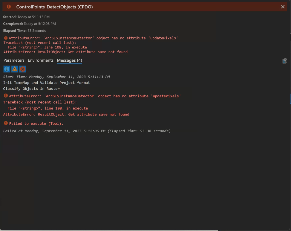

but at the end of the code I get the following error:
AttributeError: 'ArcGISInstanceDetector' object has no attribute 'updatePixels'
Failed to execute (Tool).
I do not have 'ArcGISInstanceDetector' or 'updatePixels' in my script and this error must be related when executing 'DetectObjectsUsingDeepLearning '. Is there a way to patch and fix this bug so my script doesn't error out when I Detect objects? Alternatively, is there a way to force my python script to succeed if it classifies the raster with no issues?
Error Snap Shot:Screenshot 2023-09-11 174750.png

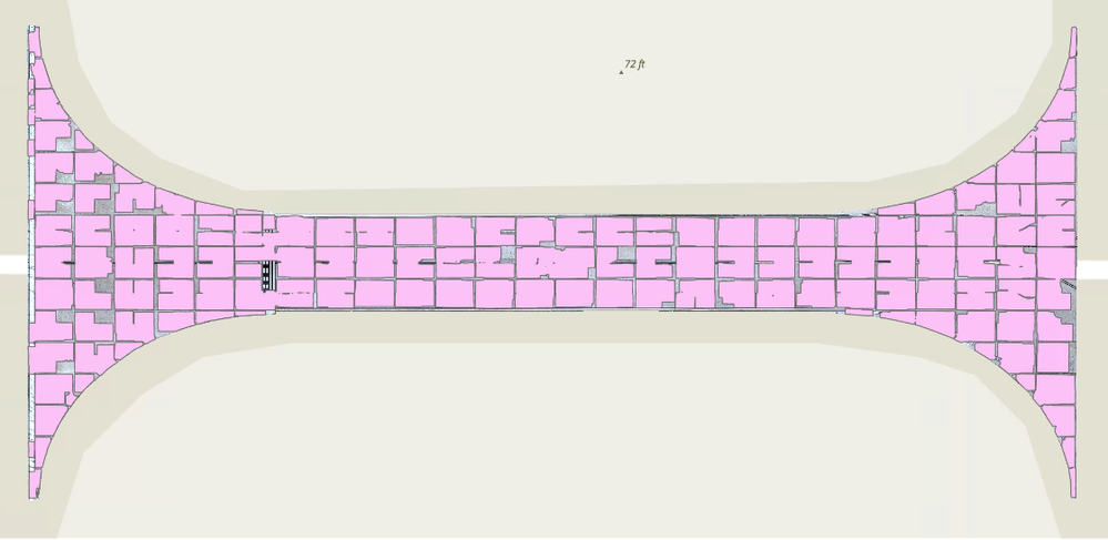

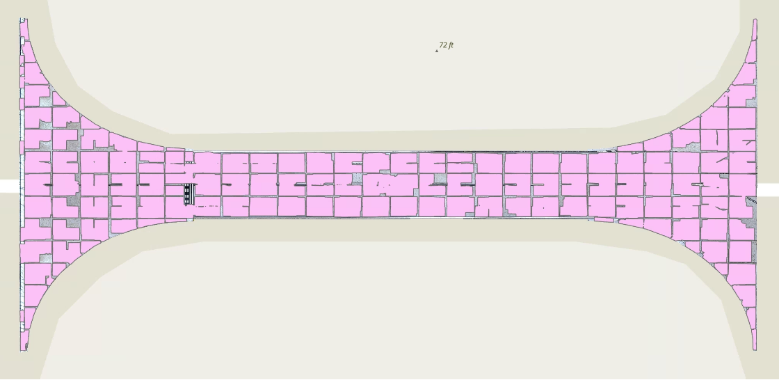

Classified Raster Snapshot:
DetectObjectsUsingDeepLearning is working as intended but I am still getting this unknown error...
