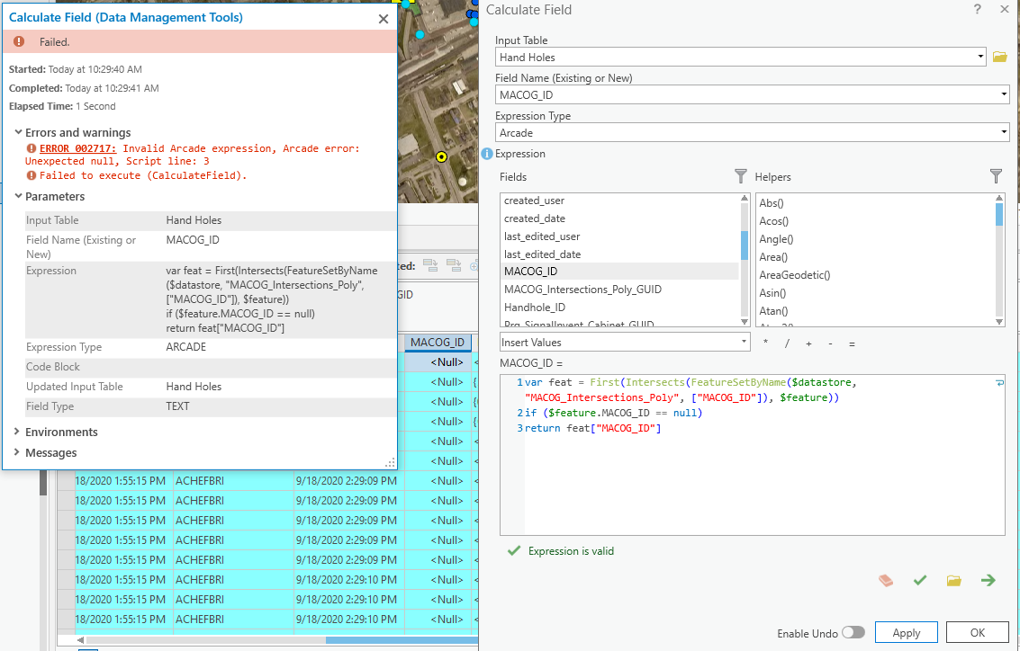

Am attempting you continue the task and am running into this error.
XanderBakker
Esri Esteemed Contributor
Hi Brian.Acheff ;
The error you are receiving may be caused by not having a result in the intersection. Can you try this?
// don't do any intersects if you are not going to use it
if (IsEmpty($feature.MACOD_ID)) {
    // intersect the data (don't retrieve the geometry when you don't need it)
    var fs = Intersects(FeatureSetByName($datastore, "MACOG_Intersections_Poly", ["MACOG_ID"], False), $feature);
    // count the resulting features
    var cnt = Count(fs);
    // don't try and access the first feature if there are no features
    if (cnt > 0) {
        // get the first feature and return the MACOG_ID
        var feat = First(fs);
        return feat["MACOG_ID"];

Xander Bakker‌,
It checks out, but returns Null
