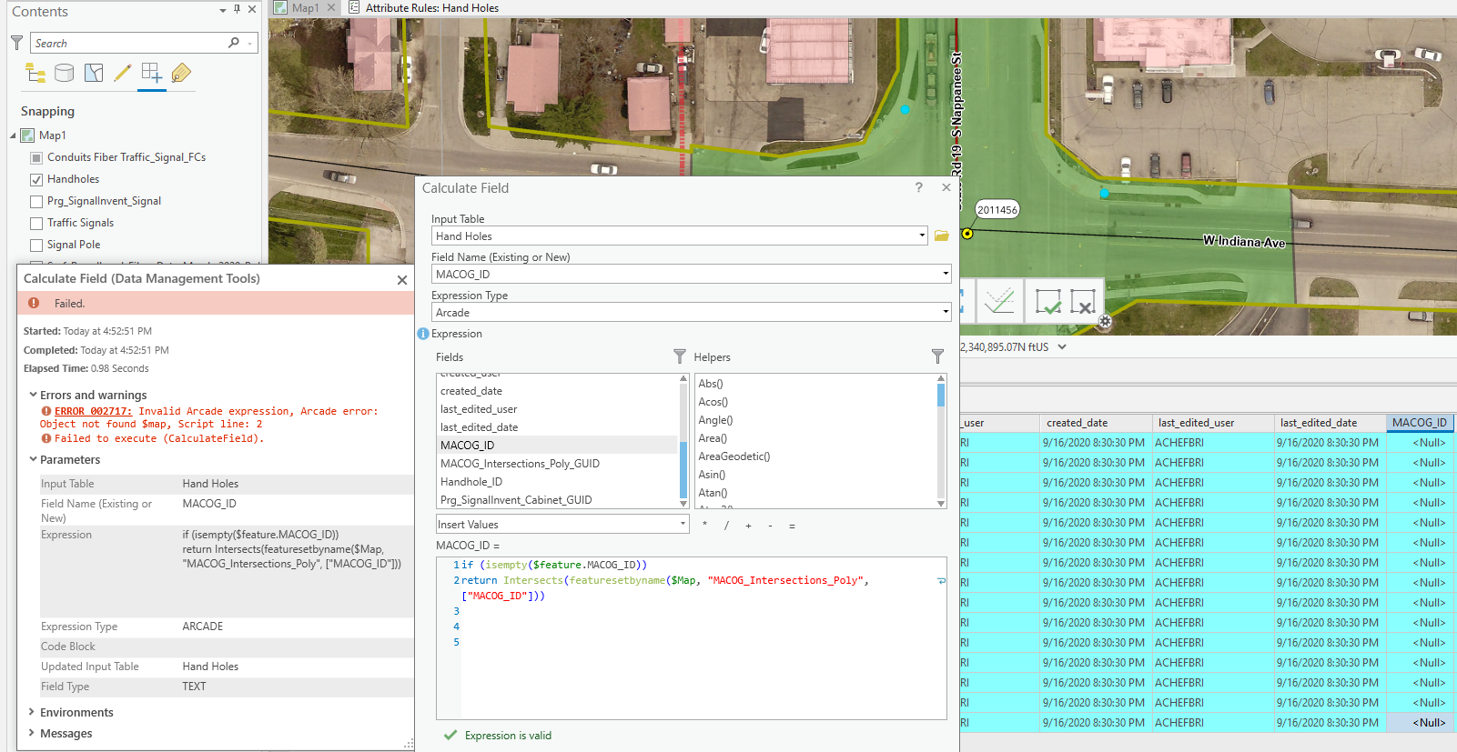

I have old features that I am adding via copy and paste to a current production feature class that has attribute rules enabled. I am having trouble figuring out a way to update "at will" specific fields that are null for the old features being brought in.
The attribute rule for the current feature populates point data fields with data from a polygon boundary vi INTERSECT, but when I perform the copy and past the fields remain null and are not updated via the attribute rule.
I know with attribute assistant you can "Run Change Rules for Selected Features" is there a simple way to do this with attribute rules or mimics the rule using ARCADE or Python in the field calculator as I attempted below?

Hi Brian Acheff ,
The error message is indicating that you cannot use the $map global variable in a field calculation of an attribute calculation rule. You should use the $datastore instead. See Profiles | ArcGIS for Developers for more information on what global variables and functions are available in each profile.

Hi Brian Acheff ,
In this screenshot on line 13 you are using as update the text 'MACOG_ID'. This should be updates array you created before. See algo the example expression called "Edit another feature class with a calculation rule." in this link: Attribute rule script expression examples—ArcGIS Pro | Documentation
