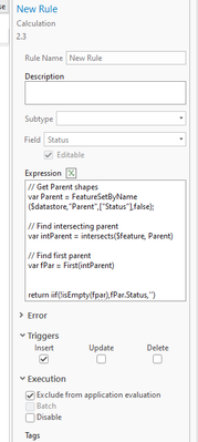

Okay, first rule
// Get Parent shapes
var Parent = FeatureSetByName($datastore,"Parent",["Status"],false);
// Find intersecting parent
var intParent = intersects($feature, Parent)
// Find first parent
var fPar = First(intParent)
return iif(!isEmpty(fpar),fPar.Status,'')
Just make sure you call out the attribute in the rule and it become easier.

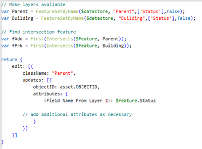

PaulMAlexander
So for example, Parent is my source polygon. I am drawing Building inside of it and it is copying the status field of Parent. When I change the Parent status, it also changes Building. This is my current expression, but it throws an invalid Key message on line 15, <Field Name From Layer 2>: $feature.Status.  Am I missing somthing? I removed the null section because the value in the field would never be null.

For starters, it looks like your variable names didn't get updated when you reworked it into your own data, so that's important. Additionally, in your return, you'd need to replace  <Field Name From Layer 2> with the actual name of the field you want to update.

Okay, first rule

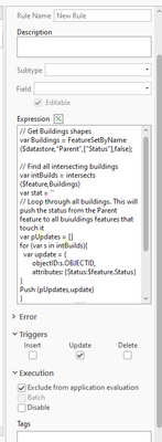

Second rule (apply this one to the parent layer) - this is one I actually put together for a different project and had forgotten about until now:
// Get Buildings shapes
var Buildings = FeatureSetByName($datastore,"Parent",["Status"],false);
// Find all intersecting buildings
var intBuilds = intersects($feature,Buildings)
var stat = ''
// Loop through all buildings. This will push the status from the Parent feature to all buiuldings features that touch it
var pUpdates = []
for (var s in intBuilds){
  var update = {
       objectID:s.OBJECTID,
       attributes: {Status:$feature.Status}
Push (pUpdates,update)
return {
    edit: [{
       className: "Buildings",
       updates: pUpdates
I just duplicated this in my environment and the rules worked, so reply back with what you find!

PaulMAlexander
Great! this helped. Had to make a minor adjustment on my end, but it worked and did what I needed it to do. Appreciate the assistance.
