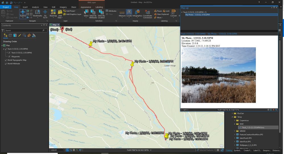

Thx!  I've downloaded the file and am working with it now in ArcGIS Pro 2.9.1.  Natively the *.kmz works just fine in ArcGIS Pro with no data conversion required.  I can click on "My Photo - 1/23/22, time" and see the photos just fine.  See attached.  I'll try converting it to a geodatabase feature class and report my findings.

That's great, so it obviously can be done.  Im using 2.9.1 also and my import looks just like yours EXCEPT, in the pop up your are showing, I see a broken link icon instead of the picture.  Attached is a pic.

Right - so I did not run the KML to Layer GP tool at all and just added the *.kmz right to a new Map View.  If I run the KML to Layer GP tool, then I see the same thing that you do.  Click the Add Data button in the Layer group on the Map core tab and add the *.kmz right to your map.  Does it mimic my screen grab earlier?
