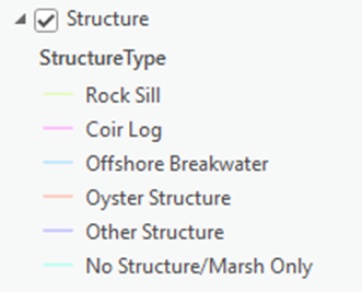

I have a Parent Feature Class in ArcGIS Pro called "Structure" that has a field called StructureType that has subtypes of Rock Sill, Coir Log, Oyster Structure, etc.  I have a related child table called "StructureInspection" to collect inspection data on these structures. One structure will have many inspections.

The datatype of the StructureType field in the parent feature class is Short (Numeric) because it has subtypes.
