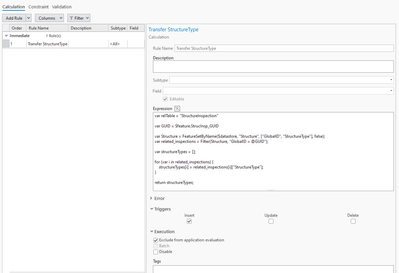

I have tried doing this using an Attribute Rule in ArcGIS Pro:
      Using the Calculation Rule
      I did not select a field; I want this to trigger with any field.
      I have it triggering on Insert, when a record is created
The Arcade expression used:
var relTable = "StructureInspection"
var GUID = $feature.StrucInsp_GUID
var Structure = FeatureSetByName($datastore, "Structure", ["GlobalID", "StructureType"], false);
var related_inspections = Filter(Structure, "GlobalID = @GUID");
var structureTypes = [];
for (var i in related_inspections) {
    structureTypes[i] = related_inspections[i]["StructureType"];
return structureTypes;
I get no errors with the Attribute Rule, but the StructureType does not populate when a new record is created in the StructureInspection table.
I would love if someone could help solve why this is not working!  Thank you!!!
