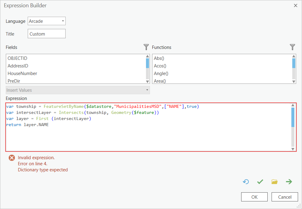

In March, 2020, I posted Chasing my tail with Arcade/Attribute Rules and Jake Skinner‌ provided an attribute rule that worked just fine for me.  Until today.  The rule  updates a field in a point feature class when a new point is created with the name of the municipality the point is located within:
var township = FeatureSetByName($datastore,"MunicipalitiesMSD",["NAME"],true)
var intersectLayer = Intersects(township, Geometry($feature))
var layer = First (intersectLayer)
return layer.NAME
When I verify the expression, I get an error:
Invalid expression
Error line 4.
Dictionary type expected
I've also deployed the same basic expression to get the Zipcode from an intersecting zip polygon and it now tosses the same error. I don't see the problem.

Hi jborgion ,
The fact that something stopped working could be due to change in Arcade (which I highly doubt) or change in the data. Can you test the expression in a pop-up to see what is returned?
I would change a couple of things:
  • You don't need to retrieve the geometry, even if you are going to use the featureset in an intersect afterwards (line one "true" changed to "false")
  • I included two Console statements on line 2 and 5 (but I'm not sure if you can see the result in Pro)
  • When you are going to access the first of something, always be sure there is something. I use a count on line 5 and 6 to validate that
  • Also define what to do when you don't find an intersecting feature
var township = FeatureSetByName($datastore, "MunicipalitiesMSD", ["NAME"], false);
Console("cnt township: " + Count(township));
var intersectLayer = Intersects(township, $feature);
var cnt = Count(intersectLayer);
Console("cnt intersectLayer: " + cnt);
if (cnt > 0) {
    var feat = First(intersectLayer);
    return feat.NAME;
} else {
    // what do you want to do if no intersecting feature was found?
However, none of these recommendations explains why a something that worked before suddenly does not work. It might be good to call support for this one.

Xander Bakker‌; I think the problem was on my end: this particular rule is based on a relationship class, and I had neglected to have that relationship class created when I tested yesterday.  (It came to me as s one of those 'eyes slamming open moments at 2 am.) So I created the relationship class and things seem to be just fine.

I spoke to soon:  I have two attribute rules that do the basically the same thing; after creating the relationship class, one works and the other tosses the dictionary error as noted originally.
This flavor works: it grabs the underlying city and adds it to a new point:
return layer.NAME
This flavor should add the underlying Zip code to the same point:
var zip = FeatureSetByName($datastore,"Zipcodes",["ZIP_MOD_ID"], true)
var intersectLayer = Intersects(zip, Geometry($feature))
var layer = First(intersectLayer)
return layer.ZIP_MOD_ID‍‍‍‍
The 'ZIP_MOD_ID' field in the Zipcodes feature class is of long numeric type, as is the field I'm applying this rule to in my point feature class.
Xander Bakker- the console() function does not work in Pro, but when I mimic the rest of your suggested code, it tosses the same Dictionary type error:
Sigh....

I just migrated the the one expression that 'works' in the FGDB environment to out EGDB environment.  The good news is it doesn't toss the Dictionary error.  The bad news is it tosses a different error...
That should just about do it....
XanderBakker
Esri Esteemed Contributor
Hi Joe Borgione ,
See my initial comment and always include a check to see if you have something before you try to access the properties of nothing.
Also, I have noticed in the past that Arcade does not always like you at access attributes using $feature.field_name, when the field name has un underscore in the name. Please use $feature["field_name"] instead.
JoeBorgione
MVP Emeritus
Xander Bakker-  words of wisdom to be sure.  In a separate email to and from Chris Fox‌, he explained that when one uses Verify in the expression window, it not only checks for syntax issues but executes the expression as well.  I did not realize that.  None the less, now that I have deployed your check, all is well.  I don't have any idea why it worked in the past, but I'm moving forward, not looking back!
