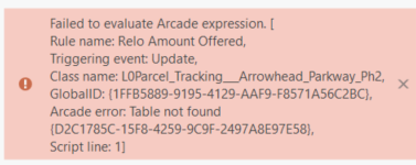

I publish the FC and related table as a service, however, when I try to edit I get the error message below.  If I look at the attribute rules of the published service FC, I notice it changes my Arcade expression from the related table name above to an ID number.
When I test the attribute rule directly from the GDB it works perfect.
Here is the portion of the expression in the attribute rule it changes once it's published as a feature service:
var table = FeatureSetByName($datastore,"{A2D0EBF1-2A6C-4EC2-BAE3-852F03E47EBB}")
Why does it change my arcade expression from the Table Name I input in the expression, to the ID number? When it does this it's making the expression not find the table name in the GDB and generates this error.
