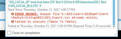

I have a simple model that exports records from a feature class to a CSV file. It works the first time, after that it gives me the error file already exists (see below) instead of overwriting the file. The setting is correct in my options:
and I get this error:
If I remove the CSV file using the catalog pane (or even go into File Explorer and remove both the CSV and XML) and refresh the model still fails, stating the CSV already exists. I have to completely exit out of Pro and restart for it to work.
Any ideas?
Thanks,
Tycho

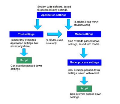

DanPatterson
MVP Esteemed Contributor
You can verify the environment settings for models when you run them from the modelbuilder window or from a model contained in a toolbox.  I would verify your settings against the application level setting that you show in the image in your first post.  Do note, that models set overwriteOutputs to False if exported to a script so you will have to enable it again in your scripts.
What is a geoprocessing environment setting?—ArcGIS Pro | Documentation

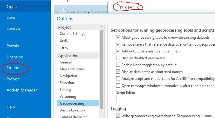

TychoGranville
Bah,  guess I'm blind... I checked...
toolbox (in the catalog pane)--> properties, no box for overwrite
model in the toolbox (in the catalog pane) --> properties, no box for overwrite
ModelBuilder tab --> Environments, no box for overwrite
ModelBuilder tab --> Properties, no box for overwrite
Main Pro page --> Options --> Geoprocessing, set to allow overwrite
In the model's window --> right-click, just model stuff
I don't know where else to look.

Based on the link Dan Patterson provided above and the image on one of the help pages you have to change the setting on the main (application) page as the model refers to that, not anything inside. So, per this image:
I changed the toggle on Pro's main page:
and my model ran successfully.
