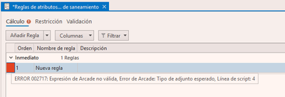

I am using arcade code to count attachments and save in field, but
Count(Attachments(item));
but I get the following error:
invalid arcade expression, arcade error: expected attachment type, script line: 4geopamplona_0-1705332358982.png
I'm using ArCGIS pro 2.9.11 and enterprise 2.9.1
My attribute rule:

I have tried the same Count(Attachments()) line and it is valid arcade for calculated fields.
