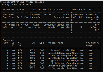

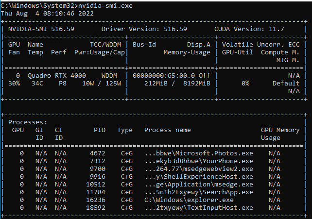

Zack_Loken
Hi @codafett
Did you ever figure out a solution to this problem? I'm running into the same issue.
