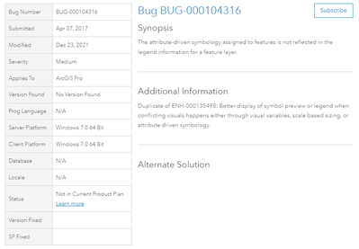

BranislavBlagojevic
@KoryKramer What is plan with this:
That a special request is needed to solve this problem?!?
Thank you!

Hi Branislav,
It was deemed that the issue is not a bug, rather an enhancement request so the bug was marked as a duplicate of the enhancement as shown in your screenshot and here https://support.esri.com/en/bugs/nimbus/QlVHLTAwMDEwNDMxNg== [ENH-000135498: Better display of symbol preview or legend when conflicting visuals happens either through visual variables, scale based sizing, or attribute driven symbology.]
The issue has been reviewed by the development team. It has not been prioritized into a release plan and will be monitored to determine its overall impact. Factors that are considered in the prioritization process include the number of users requesting the functionality, business impact, whether an alternative workflow exists, among others.
I hope that explanation helps.  Thank you.
