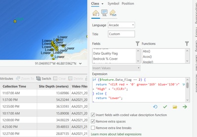

Hello All,
I have an Arcade expression that conditionally colors a piece of text in a layout.  If I remove the CLR bits it works but with a default color of black. I'd like to get it working with the color assignment if possible. Here is the current statement that proves out as working but I don't get the color I just get the actual color statement characters.
I'd appreciate any coding help.

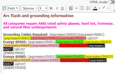

I have a similar issue when trying to color code results for Arc Flash and Grounding data.  I have a way to do it what works in a dashboard but it would not work in a pop up.  What I ended up doing was using an iff statement
iif($feature.ENERGYSWD >=8 && $feature.ENERGYSWD <9,$feature.Energy___SWD,'')
I then color coded each expression.  If the second part of the iff is simply '' then it shows nothing.

<p style="color:{expression/mad_col}">&nbsp;&nbsp;&nbsp;&nbsp;{Energy___MAD}</p>

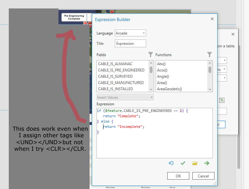

Well I tried the example above with no success. Strange that some tags work as expected but <CLR></CLR> doesn't seem to in my situation. I attached a couple more pics to show. Thanks.

Could you copy your expression directly into a reply (rather than posting an image) to see if anything going on?
GRmapper
Here is another version that provides the same issue but is slightly different from the example. Thanks.
var val = $feature.CABLE_IS_PRE_ENGINEERED
if (val == 1) {
return "<CLR red = '0' green = '169' blue = '130'>" + "Complete" + "</CLR>"
} else if (val == 0) {
return "Incomplete"

In my code example I a //return.  when I remove the // it returns the value I am looking for.
It just is not working on the pop up with the html markup I show at the bottom of my example.
This works in a dashboard.
