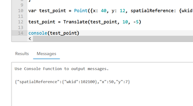

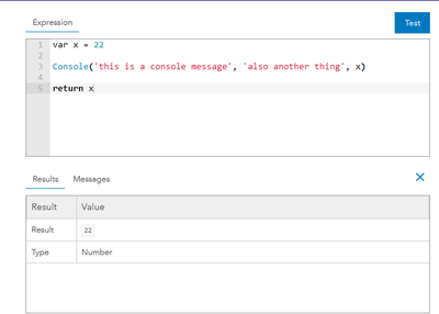

jcarlson
MVP Alum
The console is more for debugging or checking on things. Useful for longer, more complex expressions, but you can only see those messages in the Expression Builder interface, such as in AGOL.
When you test an expression, you can see there are the results and the messages.
- Josh Carlson

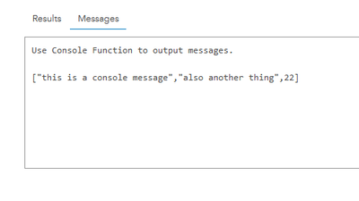

JohannesLindner
MVP Alum
I recently learned that you can also see them in Pro:
Verify the expression, then you can click on the button.
Have a great day!
Johannes
