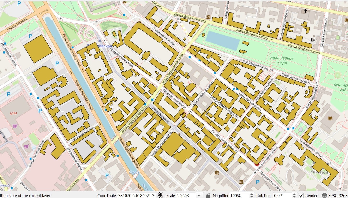

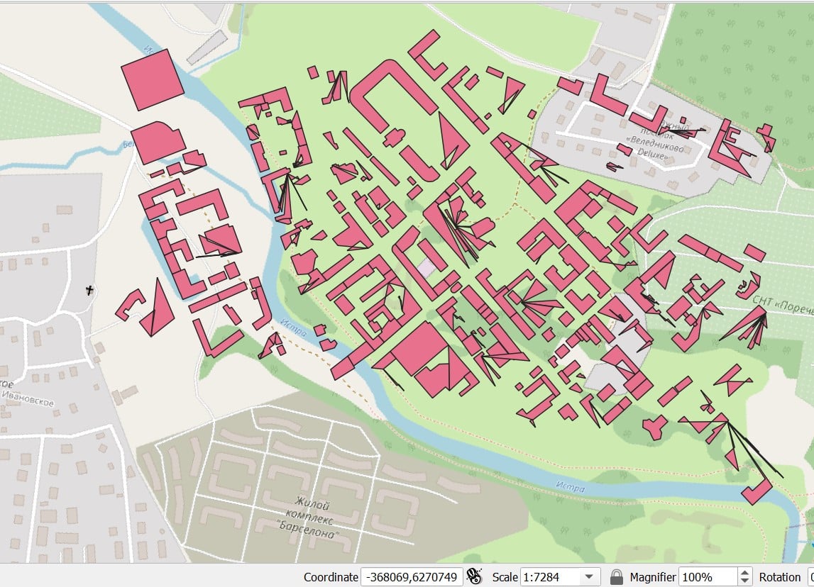

The problem is that it writes my file wrong. Instead of positive number of X coordinate it writes a negative number, while the Y coordinate stays the same, e.g. the coordinates were around +381462 and became -367560. The coordinate system is WGS 39N. In the end I have got a wrong location. What's wrong could be in the code? Please find a screenshots in attached, but don't look at the polygons' shape, it is another problem I am aware of it 🙂

not too sure, can you try assigning the spatial reference with an EPSG code rather than a template?
also in:
array.add(arcpy.Point(vertices[fid][i][0], vertices[fid][i][1], ID=fid))
I guess it should be "ID" not ID (which you have as a variable set to -1 - also not sure what that ID of -1 is meant to be doing).
