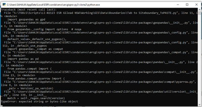

I am new to arcpy and most of python too. My new org has arcpy scripts (written by ex-employee) that would convert TAB files to shp and also create buffer zones in an shp. It was working great until we upgraded ArcGIS Pro to 2.8.3. With basic skills in python, I'm expected to debug this script. This is the script we are using -

 [Here's the image of the error][1]

But I found that the error is given when importing geopandas. the installed geopandas is 0.8.1

What are the errors you are getting?  Screen caps would be good...
That should just about do it....
Sahaja
That's the error. I found that it's the problem in importing geopandas.
