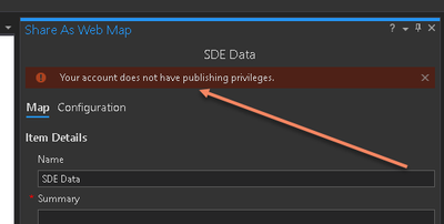

I am trying to publish a web map from ArcPro as a web map on ArcOnline. I am going to the share tab, then web map. I fill out what it requires and I am signed in, and the analyze button and the publish buttons are both disabled. I have never tried to publish anything this large before. I have a raster, a layer from living atlas and some point and polygon data. Can anyone help me? Thanks!

Hello Khines,
Do you know if you have the permissions to publish to ArcGIS Online?  What is your license level?

What happens when you click on the Analyze button at the bottom? Does it list what errors are preventing the publishing? Can you post a screenshot of your Share As Web Layer dialog?

Does it give you any message up at the top?
