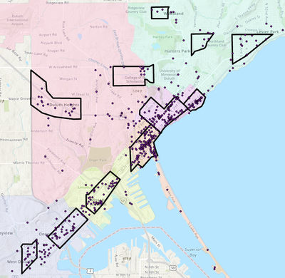

How do I select by graphic in Pro 2.7.1. I used it in ARC 10.6 but it seems like the feature is gone.

Check if the following workaround works for you.
1. Convert the graphics to polygon feature class. Graphics To Features (Conversion)—ArcGIS Pro | Documentation
2. Use Select by Location (Input Features = Point layer; Relationship = Intersect; Selecting Features = Polygon Layer)
