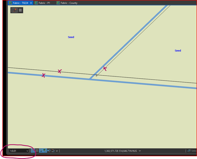

AmirBar-Maor, I've been following your videos and instructions for the past 2 years or so while developing and converting our parcel data built with regions in arc/info to our current beta parcel fabric.  The issue I'm finding is something as described in this thread, but I'll do my best to describe.
For testing purposes I've been trying to do a simple split of a parcel, utilizing 2 existing points on the polyline and using the traverse straight line tool to draw a line between the 2 points.  When I do this, the heads up display indicates the line end points are snapping to that node(s).  However, when I get to the point of creating seeds sometimes it will and other times it errors.  My issue thought is the topology.  When it creates the seeds and the fabric "appears" to be created as it should the topology doesn't appear to be retained.  If i zoom in (1:0.01) as far as possible on the point 2 or 3 separate polylines and/or parcels appear to be created and not snapped at the point.
Running the error checking and based on the seeds being created the fabric "looks" like it is correct.  But because I visually see the spatial differences between the point, polyline, and parcel, it gives me concern that the topology is truly being enforced.  I don't want to lose our topology that has existed for over 25 years in our data.  Am i being concerned over something that doesn't exist and is maybe a display issue?  I have refreshed the display cache with no luck.
I've tried so many things...... too numerous to mention, but can't seem to get a split to visually snap properly.
I've attached a screen shot to help explain.  Any thoughts are much appreciated.
AmirBar-Maor
@EddieQuinlan1
It is hard to tell if the issue is a display issue or a topology data issue without having a reproducible case. Can you work with technical support to submit a case so they can have a look into it.
Validate involves 'cracking and clustering' - does validating the extent fixes the issue?
You screenshot shows a parcel labeled as a 'Seed'  - a seed should have a smaller geometry bounded by a closed loop of lines. Please try to use  'Shrink to Seed' and then 'Reconstruct from seed'
EddieQuinlan1
Thank you for the insight.  After writing my post and further testing, i did see where validate the extent using the geoprocessing seemed to fix the issue.  Your response seems to support this.  I will need to do further testing to feel confident this is the solution.  I will review the "cracking and clustering".
I think one of the issues was my team using the "create seeds" and "build" process; thus believing the topology was built and cleaned (old school arc/info "build" and "clean" topology).  This apparently is not the case?
