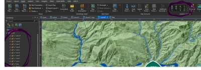

I am making a map for a client. They didn't like how large rivers were hidden behind mountains in a 3D scene, so I drew some graphics to make the river lines continuous.    Here's the layout view in Arc:Kevin_Andras_0-1782326486801.png

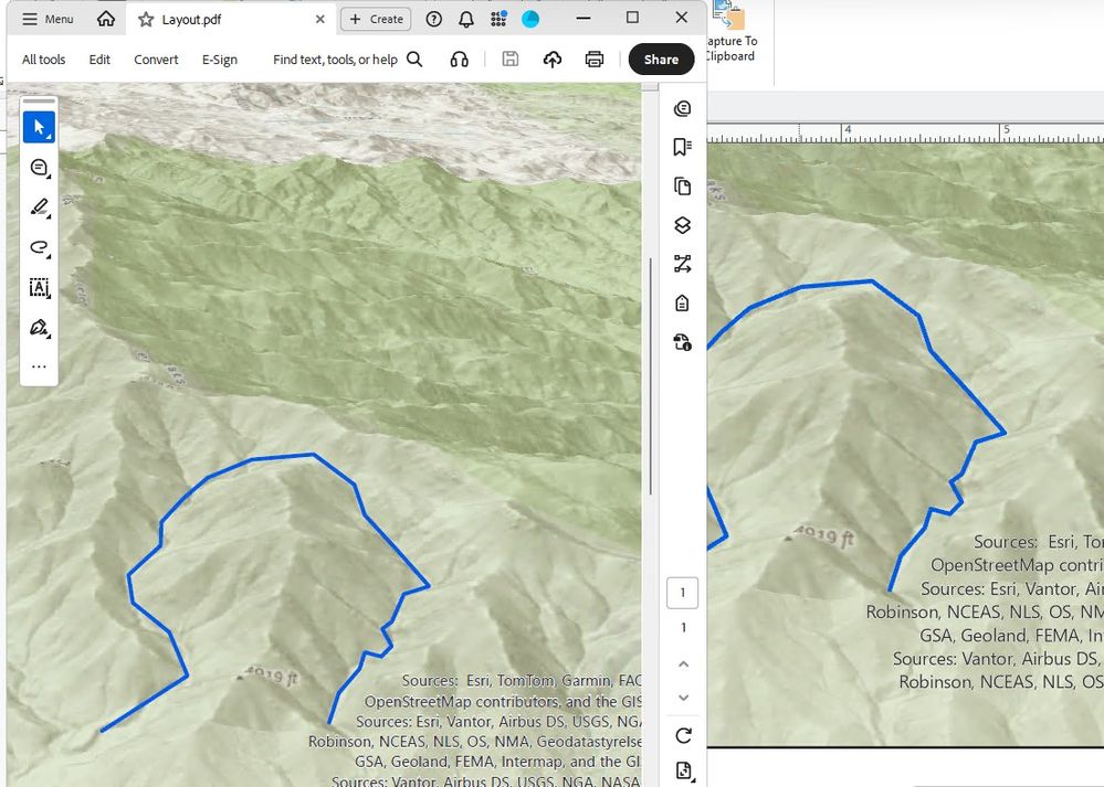

And here is the same area when exported as a PDF (TIF has same offset):
All of my graphic elements are offset similarly.  How can this be avoided?

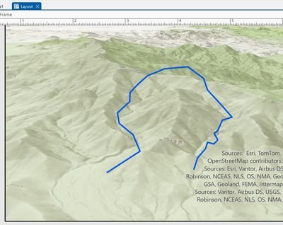

2. You could "fake" the effect by drawing a Layout graphic on top of the map frame.
Here is an example with an exported PDF.
However, since this graphic lives in "page space" and is not connected to the scene, if you change the extent, for example the tilt angle" the graphic will no longer line up.

Thanks for your response.   I fully understand that changing the tilt would affect the placement of  any graphics.   I have not changed the map orientation.  I added the graphics using the Insert tab > Graphics and Text.  They are shown as layers in the TOC under Layout, and are not in the Map Frame/Scene.  See my screenshot. Is there another way to add graphics?

As you can see from the screenshot I provided I was not able to reproduce the issue when exporting to PDF. At the moment I can't think of anything that might cause this effect.
