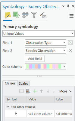

Hey all,
Having an issue that when I add another field to the symbolisation, all the classes disappear and I can't add any. Same problem occurs when using custom expressions.
tiztrain_0-1720629126285.png -->
Does the dataset have to contain data?

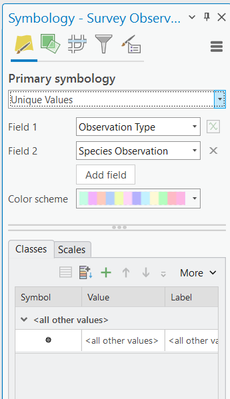

Testing this on my ArcGIS Pro and this appears to be expected behavior when you add a new field to the Unique Symbology item.  I'd recommend you add both fields first, then create the symbology second.  That way it doesn't remove the formatting.
tiztrain
@Robert_LeClair when I do that and then click the 'add all values' button, nothing loads in.
Is the only way to add the values is to manually add them all?
The 'add all values' button worked for me previously, the only difference was that it was an older version of Pro and the dataset contained data.
