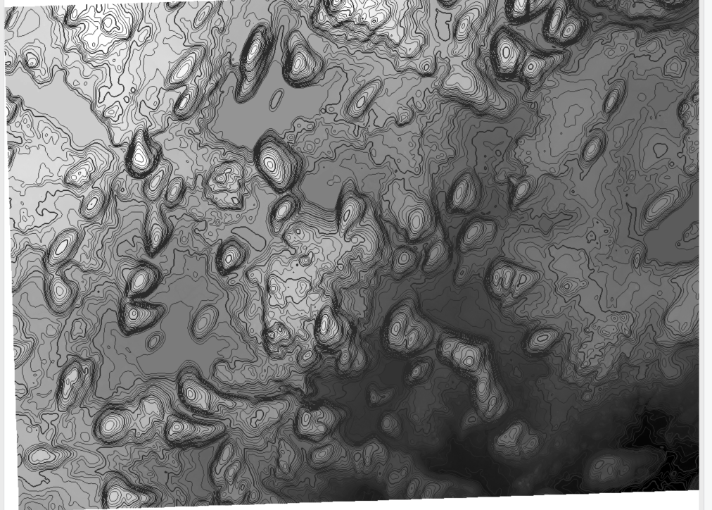

I have a DEM tif file that I created contour lines with by using:
  • raster functions
  • contour
    • Z base from the DEM tif
    • contour interval of 1
  • output is a raster layer

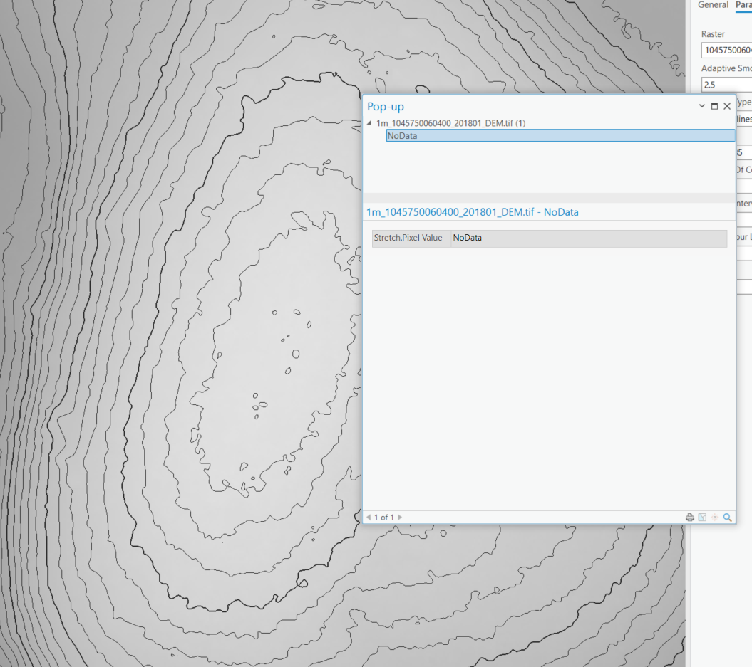

The output layer looks great, but the issue is if I click on a contour line there is no data to tell me what the elevation of that line is. I need to be able to click on a line and it tell me its elevation is 15m for example.
Is there a different way I should be creating contour lines?

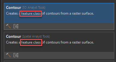

JakeSkinner
Esri Esteemed Contributor
Hi @edward33,
With the 3D Analyst or Spatial Analyst extension, you can use the Contour tool.  This will create an output feature class.
