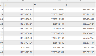

I've got a .csv file I'm trying to geocode points for. I've not seen these types of coordinates before and could use some help getting this geocode job done. Any quick advice?

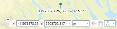

I noticed that your topic title line confuses the Z and Y values: Y:663.803216, which I assume was a mistake but if you are using the Z values as Y values then you will have problems. I also have found that X coordinate values if recorded as positive numbers in tables puts them East of Greenwich. Multiplying them by -1 tells Pro that they are in the western hemisphere such as -11973873.26 m west of Greenwich.
I used the Go To X,Y command on a map in WGS 1984 Web Mercator (auxiliary sphere) and dropped a pin at your last X,Y coordinate pair. It plunked down in Saskatchewan. If that doesn't make sense based on your client, then this is not the solution.
