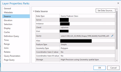

Just to expand on your instructions, I went to the layer properties, clicked on Source, then clicked on the edit icon for Query (see image below).  In the Query window I can double click on the fields to be added (then add commas of course).  I guess I could also copy/paste the query from SQL Server.  Thanks again for helping me out.
