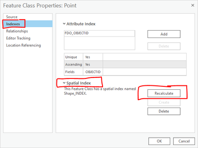

Alex_at_Exprodat
Just in case anyone else comes across this problem, this solution worked for me. It was the same issue/fix from ArcMap where the spatial index of the item you want to snap to needs refreshing. In a geodatabase, this is usually done automatically but sometimes it gets stuck and needs a manual refresh.
Go to the Catalog (pane or view), browse to the feature class you are snapping to, right-click and open Properties. From there, go to Indexes and expand Spatial Index. Click the Recalculate button.
Once that is done, click OK and go back to your map. I had to disable and re-enable snapping from the ribbon, but as soon as I turned it back on, my sketches were snapping to the existing features correctly again.
