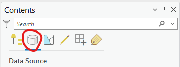

Do you mean from the Contents View?
AndrewBarker3
Regular Contributor
Not that one, you need to click the View Menu at the top.  Then in there choose Catalog View (not Catalog Pane).  From there click the Data Sources icon in the ribbon.  Then the Workspace icon near the top left in the ribbon.
