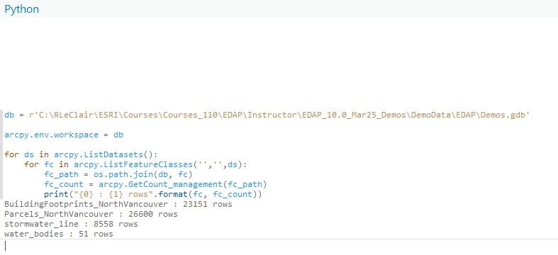

Two quick way to get a feature count outside of the methods you described already:
Run the Get Count (Data Management)—ArcGIS Pro | Documentation geoprocessing tool in batch mode
Or open the Python window on the Analysis tab and in the Geoprocessing group, click the dropdown for Python and choose Python Window.  In the Python window, copy/paste the following code into the bottom row of the Python window and hit enter to run:
db = r'<your path to the file geodatabase'
arcpy.env.workspace = db
for ds in arcpy.ListDatasets():
for fc in arcpy.ListFeatureClasses('','',ds):
fc_path = os.path.join(db, fc)
fc_count = arcpy.GetCount_management(fc_path)
print("{0} : {1} rows".format(fc, fc_count))
