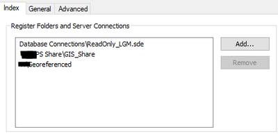

With in ArcMap in the Search window (panel) you have the capability to connect to databases and folders to also search those. This functionality is super handy, not only for people who may not know the database well but in other scenarios too. For instance, I have connect to a folder where we store all our georeferenced asbuilts. Each asbuilt has an image ID in it's file name so I can use the Search window to search on that image ID (that I get from identifying a feature) and immediately pull it into my map. I love this functionality.

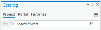

Does Pro have anything like this? You can search within a Project but even when I have a connection to the database and a folder connection to certain folders, the search only seems to return maps and layouts. Am I missing something?

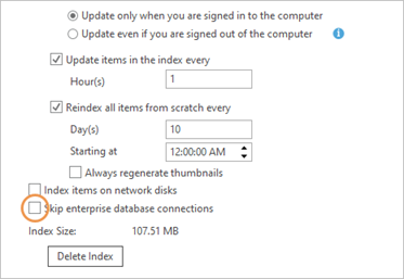

Heather, your image looks like your connection is to an enterprise geodatabase. The contents of enterprise geodatabases aren't indexed by default in ArcGIS Pro. To enable indexing, go to the Settings page (click Project tab in a project), click Options on the left, and click the Indexing option. In the Options dialog box, uncheck the box that says Skip enterprise database connections. Same thing for network folders--except you have to check the box to index them. Index project items

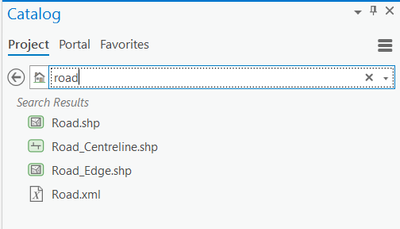

It works for me in the Catalog pane (ArcGIS Pro), even for folders that are not added as folder connection.
It won't search for folders, though. You need to use Windows Explorer for that. But the files that ArcGIS Pro can read/detect, it should display.
