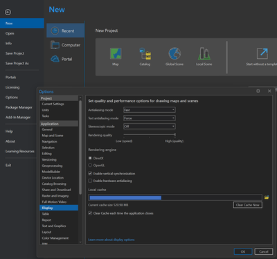

One "usual" suggestion that you will find (and you may already have this option enabled) is to clear your cache when you close your aprx. This setting is found in the Options pane/Display settings of the aprx itself, and to enable it, provide the checkmark in the "Clear Cache" line:
NickN
yep, I already had that turned on.
