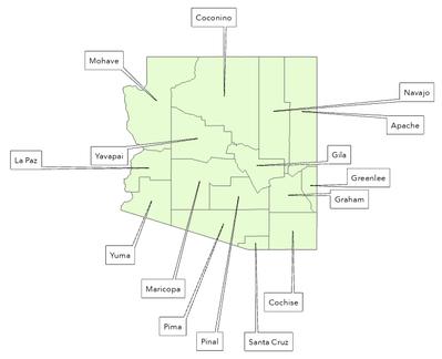

Apply a very high interior feature weight to the label class labeling properties of the focus county. If you set it to the maximum 1000 it will prevent even the callout lines from overlapping the county interior and no labels will place, but if you use a very high value such as 999 it will deter the majority of labels from placing over that area.
Here's an example labeling the counties of Arizona with this technique:
