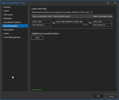

Hi @emiller you mentioned the 2 layers are in NAD_1983_3TM_111. For the map that reproduces this, what is the coordinate system of the map? Map properties > Coordinate System page > example:
Also what Transformations are set (on the Transformations page)

Thank you for helping with this. The basemap is WGS1984 and the Transformation is NAD1983 to WGS1984.
Scott_Harris
I'm assuming you mean the coordinate system of the map is WGS 1984 (which also happens to be the coordinate system of the basemap)? If you provide a screenshot, that will help clarify.
When editing, it's recommended to have the map and the layers being edited in the same coordinate system.

The coordinate system of the basemap is WGS1984 and the layers are NAD1983. Thank you for the recommendation.
