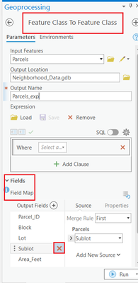

If you want to export the feature class with desired fields, use Feature Class to Feature Class. Use the Field Map to remove the undesired fields.
If you want to export just the table with desired fields, you could use Table to Table. Use the Field Map to remove the undesired fields.

If you need to export the tabe from ArcGIS Pro for use in other Software, you can use https://pro.arcgis.com/en/pro-app/latest/help/data/tables/export-tables.htm (mentioned above) which supports csv, txt and xlsx as output. No need for clipboard copy/paste.
