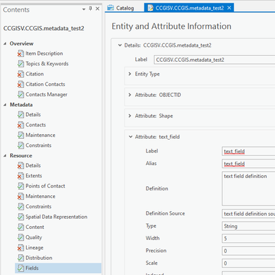

While testing my code I would manually make edits to a test dataset for validation and export the xml files to view the schema changes.

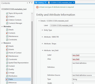

In the ArcGIS Pro attribute editor this is found under Resource > Fields > Entity and Attribute Details
When I add multiple enumerated domain values to an attribute a validation error pops up “at least one type of attribute domain is required.” And I get a red X on the Fields tab.

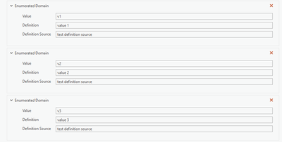

The xml schema it creates for this attribute looks like this:
      <attr>
        <attrlabl>text_field</attrlabl>
        <attrdef>text field definition</attrdef>
        <attrdefs>text field definition source</attrdefs>
        <attrdomv>
          <edom>
            <edomv>v1</edomv>
            <edomvd>value 1</edomvd>
            <edomvds>test definition source</edomvds>
          </edom>
          <edom>
            <edomv>v2</edomv>
            <edomvd>value 2</edomvd>
          </edom>
          <edom>
            <edomv>v3</edomv>
            <edomvd>value 3</edomvd>
          </edom>
        </attrdomv>
There is a single attribute domain value (attrdomv) tag with multiple enumerated domain (edom) tags nested inside of it.

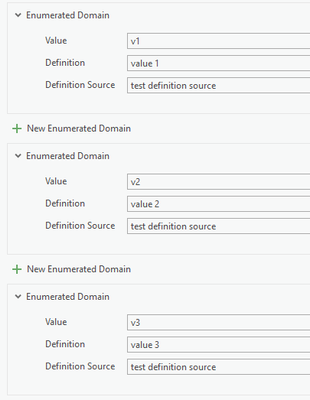

However, the metadata editor now displays strangely for this layer. It is displaying an option to insert a new enumerated domain in between each already established domain.
Is this a bug in the metadata editor?
