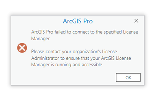

I tried to activate arcgis pro with an authorization file, but it said is been successful activated. but when i enter to arcgis pro its display "ArcGIS Pro failed to connect to the specified License Manager". What should I do? please Thanks. please i need helpDjillaliBehourah_0-1702932329170.png

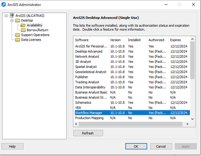

my type of license is "Single use", the bad news is i cancelled it by mistake
AmnoyAm
Just noticed your response to Cody.  So you have a Single Use Desktop license.  You successfully authorize Desktop Single Use.  You can use ArcMap, ArcCatalog, etc.  This is the classic client application.  It also means you have a Pro Named User license to go along with it.  You will need to create an ArcGIS Online account if have not done so already.  Start with the following document:  https://pro.arcgis.com/en/pro-app/latest/get-started/set-up-an-arcgis-online-organization.htm.
