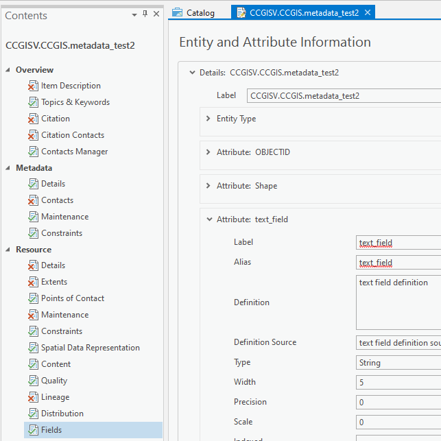

While testing my code I would manually make edits to a test dataset for validation and export the xml files to view the schema changes.
In the ArcGIS Pro attribute editor this is found under Resource > Fields > Entity and Attribute Details

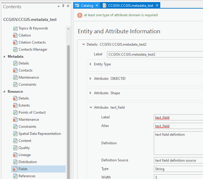

When I add multiple enumerated domain values to an attribute a validation error pops up “at least one type of attribute domain is required.” And I get a red X on the Fields tab.

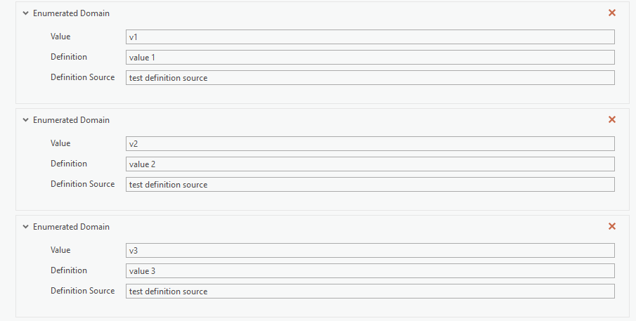

When I manually alter the schema of the xml file to include multiple attribute domain value (attrdomv) tags each containing a single enumerated domain (edom) tag the error goes away. This is true in both the USGS validator and the built in validator in ArcGIS Pro.

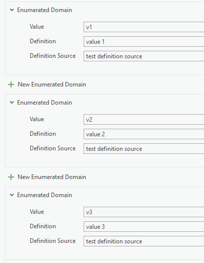

However, the metadata editor now displays strangely for this layer. It is displaying an option to insert a new enumerated domain in between each already established domain.
Is this a bug in the metadata editor?
